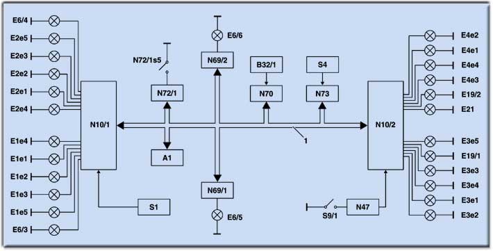

Credo anch'io che il problema sia nella SAM posteriore :
Exterior lights
1 Databus (CAN-B) E4e3 Reversing light
A1 Instrument cluster E4e4 Stop light
B32/1 Lights on sensor unit E6/3 Left side marker light
E1e1 Main beam E6/4 Right side marker light
E1e2 Low beam E6/5 Left exterior mirror turn signal lamp
E1e3 Side light and parking light E6/6 Right exterior mirror turn signal
lamp
E1e4 Fog light E19/1 Left license plate lamp
E1e5 Turn signal light E19/2 Right license plate lamp
E2el Main beam E21 Center high-mounted stop lamp
E2e2 Low beam N10/1 Front SAM control module with fuse
and relay module
E2e3 Side light and parking light N10/2 Rear SAM control module with fuse
and relay module
E2e4 Fog light N47 Traction systems control module
E2e5 Turn signal light N69/1 Left front door control module
E3e1 Turn signal light N69/2 Right front door control module
E3e2 Tail light and parking light N70 Overhead operating unit control
module
E3e3 Reversing light N72/1 Overhead control panel control
module
E3e4 Stop light N72/1s5 Hazard warning light switch
E3e5 Rear fog light N73 EIS control module
E4e1 Turn signal light S1 Exterior light switch
E4e2 Tail light and parking light S4 Combination switch
Guarda qui :
Failure of databus (CAN-B):
-Tail light and parking light (E3e2,E4e2)
-Left and right license plate light (E19/1,
E19/2)
Failure of rear SAM control module with fuse
and relay module (N10/2):
E19/2)
Fallimento di bus dati (CAN-B):
luce -tail e di posizione (E3e2, E4e2)
luce-sinistra e destra targa (E19 / 1,
E19 / 2)
Guasto del modulo di controllo SAM posteriore con fusibile
e modulo relè (N10 / 2):
E19 / 2)
